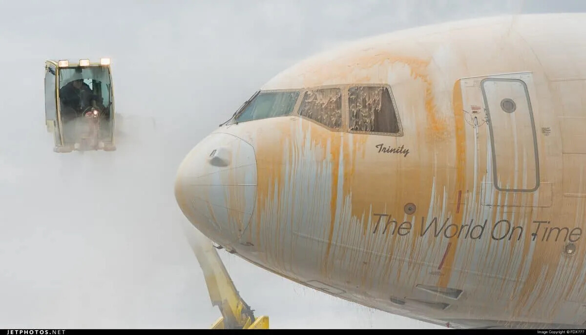

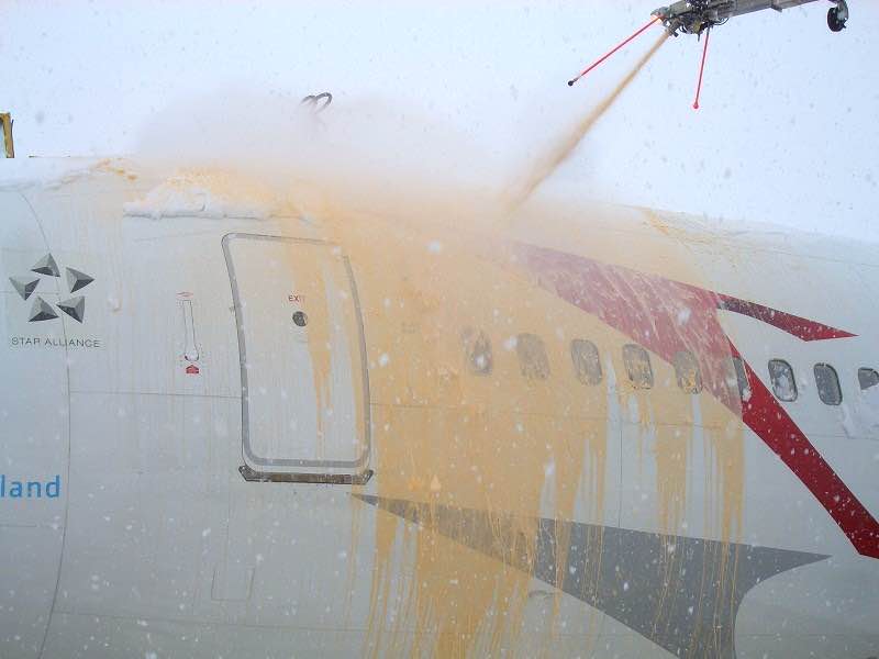

At my station (and most of my company) we use Type 1 and 4 De-ice/Anti-Ice Propylene Glycol Fluid. Which are Orange and Green respectively. As the names suggest, Type 1 De-Ice fluid is the wash and Type 4 Anti-Ice is the wax so to speak which prevents more accumulation from adhering to the wings and tail up until takeoff speed. Where It then rolls off the surfaces and the plane looks normal.
It would be nice to see the automatic process spray an orange color and slowly coat the plane over time in orange, and then if possible show the wings and tail getting covered in green. Some planes that are usually on the smaller side take type 4 along the top of the fuselage as well. In my experience this is anything of the E145/CRJ2 size and below. I have not deiced any turboprops in my 7 years of doing this so they may have a different application process. For the ease of animation its probably easier to coat the whole plane, or just wings and tail in green Type 4. Then on takeoff the type 4 could start to dissolve/fade off the plane as its in the air.

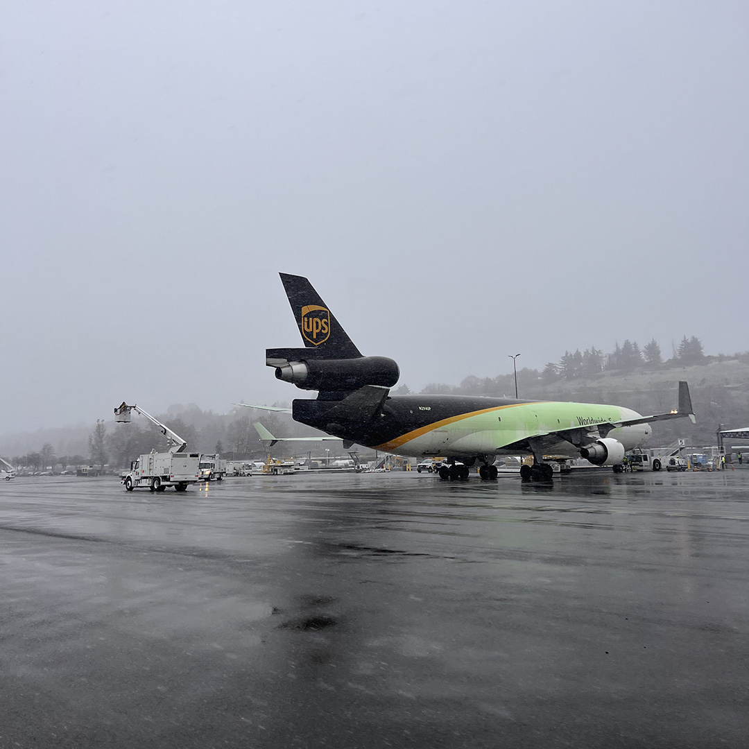

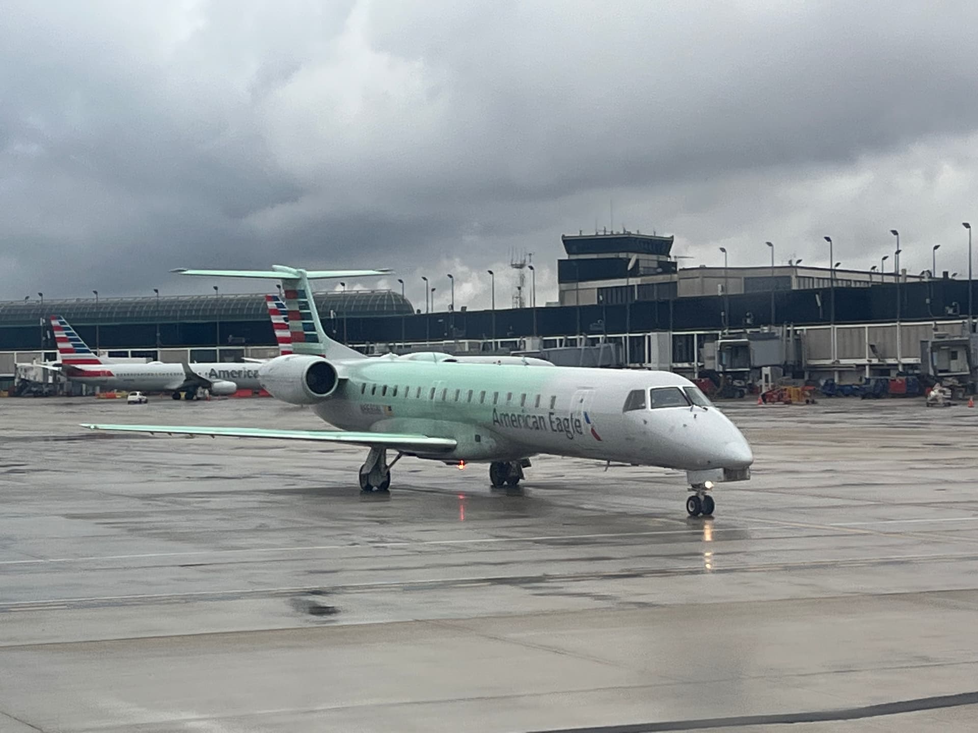

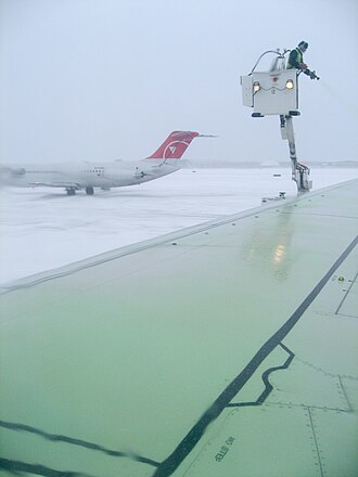

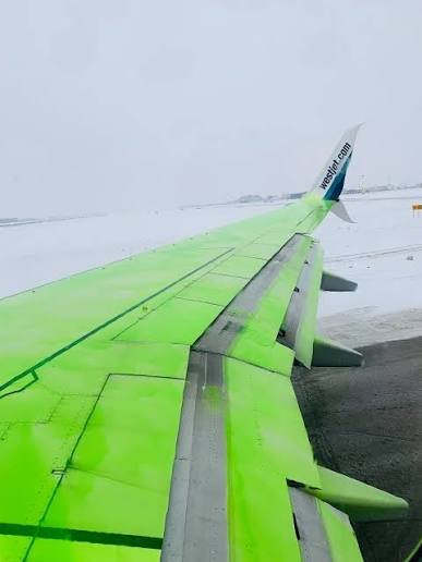

I was actually just about to make this feature request but you beat me to it! Yeah, I would love to see this in the game, seeing a bunch of green planes taxiing around during winter would just totally add to the vibe. Here are some more pictures of kinda what this could look like:
Oh man that West Jet is REALLY green! The new fluid we are using is so faint it doesn’t even look like you put any down. Cheap!
Those are really good photos for type 4.
