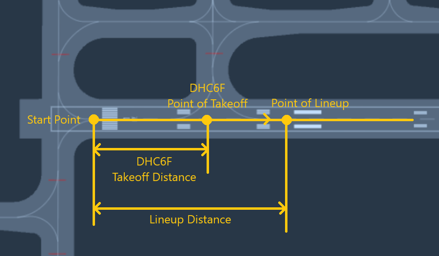

Suppose the start point to be the point on the runway where the aircraft lines up and waits for takeoff clearance, the point of climb to be the point where the aircraft rotates and gains altitude (where then other aircraft on runway 10L can line up and takeoff, or aircraft can land on runway 10R), and the point of lineup to be the point passed by the aircraft taking off which then allows other aircraft to line up (but not takeoff).
As has been implemented in the game, the point of lineup must be positioned in front of all runway entrances, so that taxiways closer to the start point do not gain a time advantage and allow planes there to line up earlier, preventing farther entrances from building a departure queue.
The distance between the start point and the point of climb will hereafter be referred to as the takeoff distance, and the distance between the start point and the point of lineup will be referred to as the lineup distance.

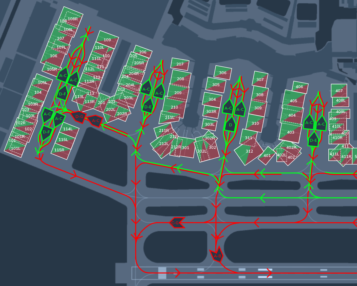

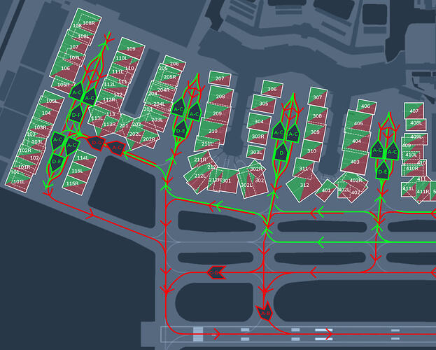

However at GRU, there are 2 taxiways being used for takeoff. Typically planes use taxiway G (the west/left one), but planes with runway category A & B use taxiway H (the east/right one). This means the point of lineup is positioned east of taxiway H farther away from the threshold.
However, taxiway H is not used for category A & B aircraft if they are parked at terminal 1, terminal cargo, or the west side of terminal 2A. Unfortunately DHC6F can only park at the mentioned terminals because they host the only cargo stands at the airport. This means DHC6F always needs to take off from taxiway G, resulting in a longer lineup distance.
Hence the lineup distance is longer than the takeoff distance. This is an exception to the typical behaviour of the other way around. Since the game only checks if other aircraft can line up after the point of lineup, DHC6F taking off so early means it never passes through the point of lineup on the surface of the runway. This results in the planes waiting to line up to be deadlocked, with the statuses still being “Runway occupied” even after the aircraft has disappeared after flying long enough.
