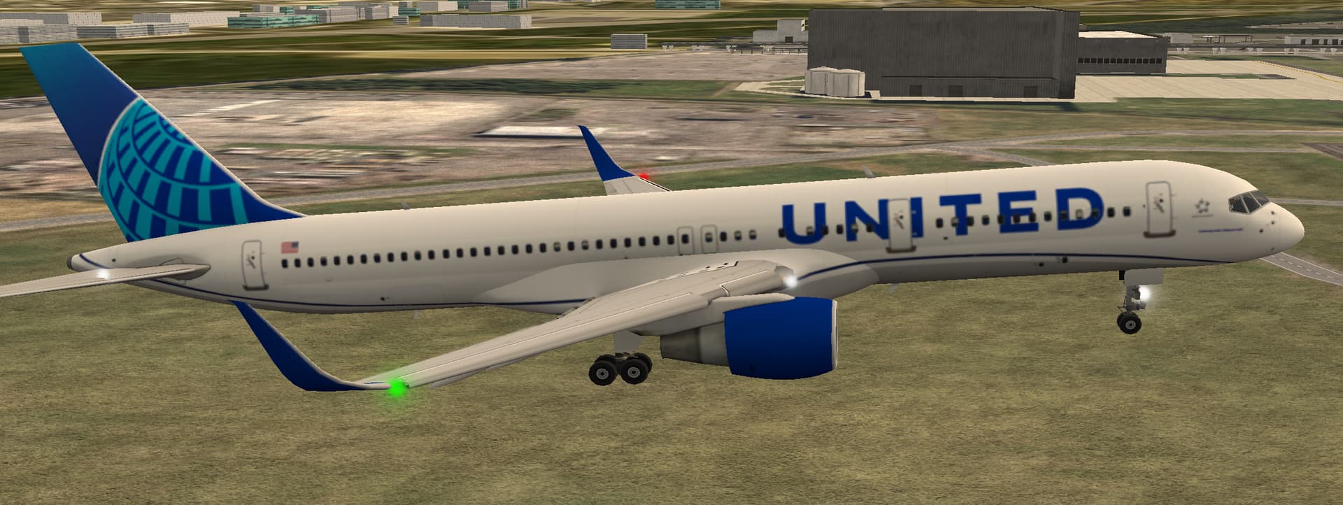

United B752 (both liveries) shows up with PW engines instead of RR engines.
Buy a United B752 contract at any airport they are available.
